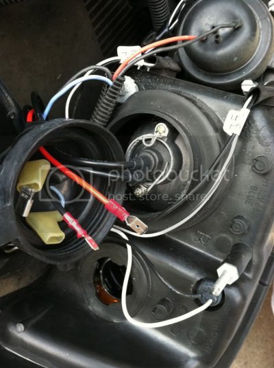

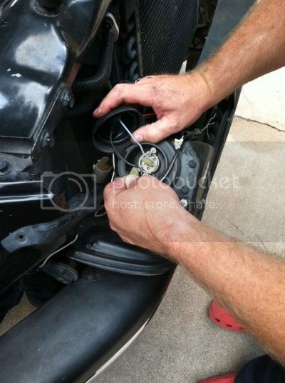

So first you wanna expose the internals of the light, and disconnect, the connectors.
remove the stock bulb. Should be able to slide it out, might be a small clip holding it in.
You wanna cut a hole in the rubber backing so you can put the wiring/bulb through it, my kit came with a grommet to use after the hole was cut. then you can try to put the HID bulb in the housing, if it doesnt go in with ease, stop, widen the slot. Mine was way tight, had to open it up with the dremel.
Insert light, along with clips. insert spades to connectors, crimp.
run wiring to ballast, and mount ballast. I used zipties, and they have held up find, be sure to check fitment after a few rides.
Right
Left
Ballast should have one side going to the bulb, and one side connected to the stock light power source.

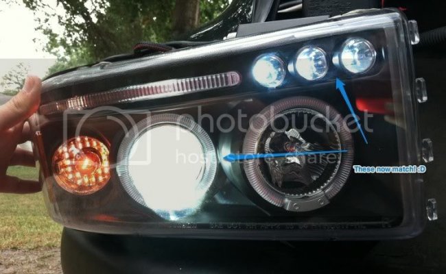

make sure everything is plugged up and you should be good to go.

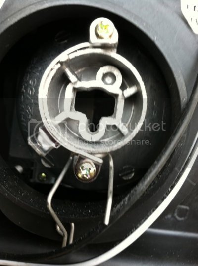

Here is a shot of what the light clip looks like

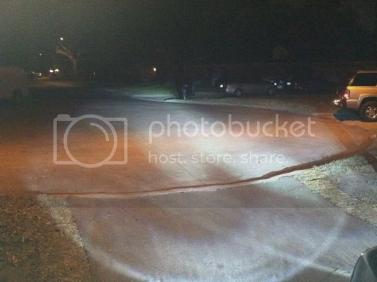

I had similar results with the Ebay Projector lights. Better than stock, likely.
But the light pattern sucks compared to a real Xenon Projector setup.
