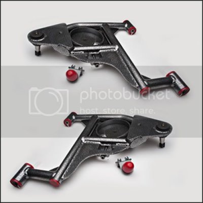

I found some used the djm control arms they say are 4 inch drop but I don't think they made them in 4 inch. does anybody know if they ever did?

Hmm... I found 4" control arms for 2nd gens, but only 3" for 2002-2005.

that's what I thought are these for a third gen

It's hard to say... they all look very similar... and I bet the only way to tell would be by measurements/fitment.
These are for 02-08

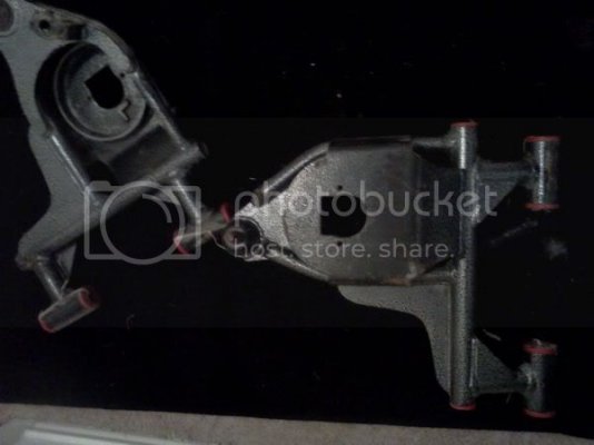

Hmm.. I guess the difference is where the coils go... might have to just call DJM lol

I did they were not much help all the pics I looked at they look like they are for 02-05

I have those arms in my truck, 05 1500. The lowest they go is a 3 inch drop from what i understood. Make sure you replace the ball joints since mine are 5 months old and already shot.

From the research i did before buying mine, the djm arms are a half inch narrower on each side. I dont have any issues steering wise. They did come with new sway bar links and i do rub a little bit but im also running a 305/50-20 tire all around so they rub on just about everything. my wheel well liners have worn away to almost nothing from them hitting on bumps.

Theyve held up great so far. my only complaint is the powder coat is slowing being killed by new england road salt. youll also want to pick up some sway bar links for an 07-15 lincoln navigator. the stock links will no longer fit and the navigator links are a double ball joint to make up for swaybar to control arm alignment issues
