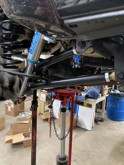

Based on my discussion with core, the johnny joint goes on the axle, not the frame. I would verify that with them.
On my lowered RCSB, that's what I was told. I didn't re ask on my 4x4

I know my control arms are installed correctly with the exact torque required, thanks to @Quick_Shifter.

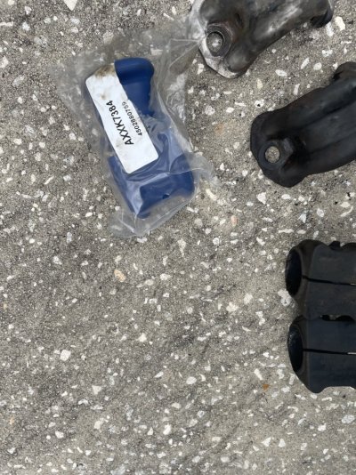

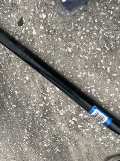

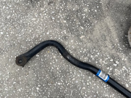

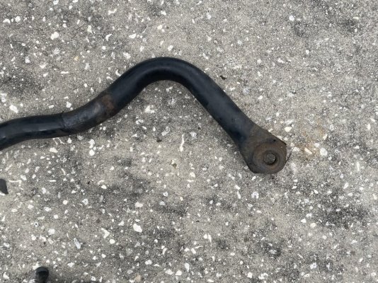

Speaking of rust:
I had a pair of Moog front stabilizer bushings. I removed the old bolts & brackets this morning. I cut the original bushings off. The brackets had a bit of rust on the inside and on the outside. Especially where the bolt head was. I could see there was rust on the stabilizer bar as well. I decided to remove it. It’s in the garage now.
This may sound like a dumb question. Have you removed the rust, primed and painted your front stabilizer bar? This one is heavy duty. I was going to hit the worst areas with a grinder and a flap disc sanding pad. The ends of the worst wearing connects to the end links. But there’s also rust where the bushings and the brackets were.
I cleaned up one of the brackets to remove the rust and any peeling paint. I haven’t done the other one yet. Have any of you guys painted these before?

Nothing wrong with cleaning up some rust man! Go for it!

Yup, that front bar is becoming like a unicorn. Lots break then the search is on. Not many aftermarket, if any, and they are disco for certain years.
I'd clean it up and check for obvious damage.
