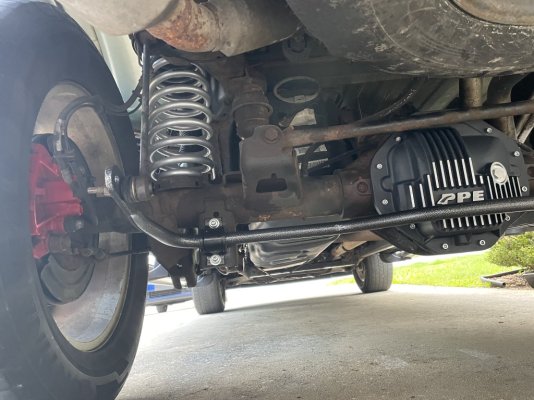

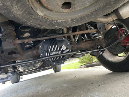

I removed the rear differential cover yesterday. They use a ton av sealant. It took me quite a while to get all that cleaned up. I put clean towels around the rear gears before scraping and scrubbing. I put the new PPE rear differential cover in. I have to fill that today (redline 75-140)
I removed the rear sway bar yesterday. Putting in the 1” Helwig stabilizer bar kit today.
Then I’m removing the rear shocks, rear coil springs, and installing the Eibach Pro lift kit rear springs & shocks.

I got the new PPE rear differential pan filled today (redline 75W-140. Then I got the Hellwig rear swaybar in. I have to contact them to verify the torque settings.
Then I installed the rear Eibach Pro lift springs and shocks. I’ve read their instructions and it said “use the hardware provided.”. There was no hardware!! so I cleaned up the existing bolts and nuts from the old shock. On the bench grinder wire wheel attachment.
I completely forgot I had ordered those Thuren specialty wrench and nut/bar fittings a couple years ago. That helped getting the top strut inside bolt/nut off. Then the other two components that have the built in nut/bar assembly. That makes getting the top inside nut tight when torquing . Those things are worth their weight in gold!!! I saw other videos where guys cut a wrench down to like a 2 inch stubby. The Thuren kit is awesome!

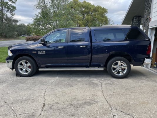

Busy day today. Right now it’s about 12 3/4 inch from the top of the wheel to the fender.
I have R20/275/60 tire. They’re shot.
I have the upper control arms on order along with the inner and outer tie rods. Everything else I have for the front end (Eibach Pro lift springs and struts, CORE 4x4 upper control arms, an new hubs/bearings.
I was disappointed with Eibach. They included two zip ties with no explanation. I figured they had to go on the bottom of the rubber boot on the rear shocks. So it wouldn’t slip back up.
