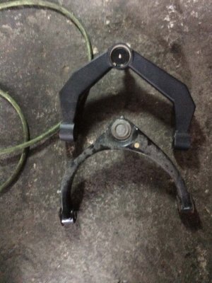

This seems to be all over, no consistency at all. I've heard of some getting by with the 2.1" setting but one guy said his popped at 1.4" setting. If you're on a budget, here's a cool alternative of putting older 4th Gen UCA's on a newer truck.
http://www.ramforum.com/f40/2011_ucas_2014_a-48119/

Cruizer .. So you are suggesting ordering new 2012 UCAs and installing them? Wouldnt they be built the same as the problem ones from 2014?
BLKMAGIC
Mar 19, 2013
550
118
no, he is suggesting finding low mileage used from a 2012 or earlier since those are not having any issues...anything new is going to be the new style and will result in the same issue

Yeah, I'm not suggesting anything. That's someone else's suggestion I referenced. But to answer the question, I'd try and find some at a scrap yard or something. Seems the cost is considerably lower than some of the options other's have went with.
