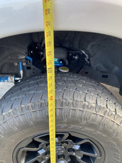

gents, sorry about not getting any replies out there.

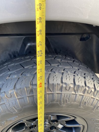

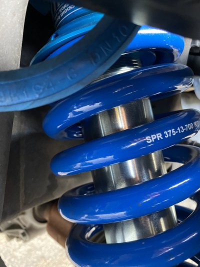

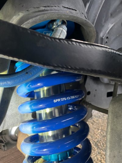

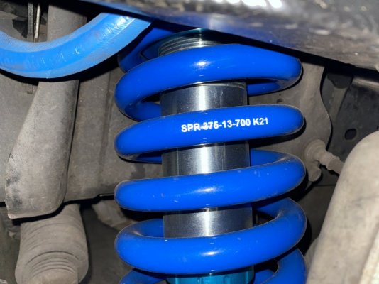

I did reach out to Carli several times. I couldn't ever get them to tell me if the spring they provided was correct. you can see in the picture it is the 700 spring. that seems more diesel to me but I couldn't get them to tell me any answer on that. there best answer was to drop my tire pressure in the front to 35 and the rear to 30. well doing that would have made my bilstiens feel like they were clouds.
it really was allot back and forth with Carli over email and phone but haven't gotten any improvement.

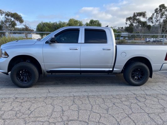

it feels like it is up on its tippy toes on the from end. like its too lifted for what it should be. I complained about the front being more than 1 1/2" higher than the rear. I don't like that look at all. the back end feel significantly better than the front. when I pull to a stop the vehicle kind of rocks back and forth as the weight transfers front to rear and back to the front.
If I go over any speed bump I better take it very vey slow or it sounds like thngs are going fall off the truck. the truck just isn't compliant as it travel over broken roads.
going with Carli everything is supposed to good right out of the boxes. the preload gave me too much front lift and I think the spring was was too heavy rated. should have probably have been a 500 not a 700. that was the first question I asked and never got an answer.
I live in Fallbrook CA and would actually love anyone who know how these things are suppose to feel can see if I am all full of Shhh or what. it's ruined the ride I had before I put the Carli kings on my truck.i

Have you talked with Carli yet? What did they say? I have zero personal experience with them but would at least verify they sent the correct shocks and springs and didn't have some mix up, or something you got is defective. How much preload do you have on the fronts? Sometimes people forget about downtravel....I've seen people jack up the front of their trucks where they don't have any downtravel left which makes for a very poor ride. Not saying this is what is going on, but just curious.

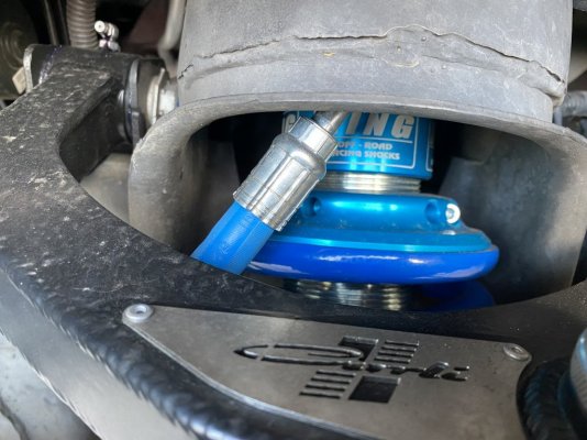

I think that might be part of the reason. my front is too high and I have no down travel. I have tried to adjust the Allen bolt at th collar buy the way it is positioned doesn't let me reach the Allen screw. if I can't get that loosened up then I'm going to have to take the all of the way off my truck to make the change. If the spring is correct then may the preload has too much tension on the spring.

I'm sorry you're dealing with this still, I think you're on to something with the spring rate being too high, @ram1500rsm what do you think?

Front end being 1" higher definitely takes front end travel away. Lower the front an 1" or 2.

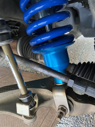

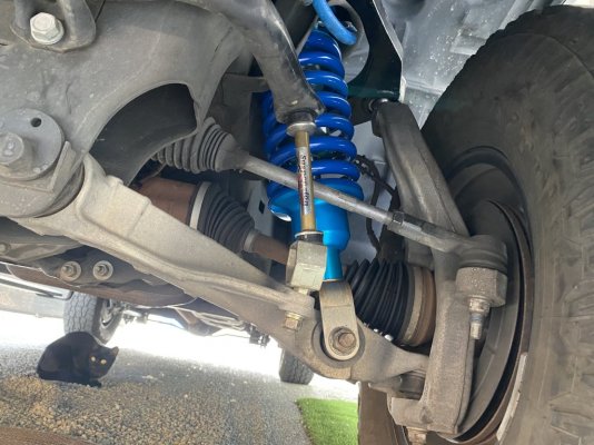

The suspensionmaxx front links look like they are installed incorrectly or you have the 2wd version. They will limit down travel when not functioning properly.
Dirt king also uses 700lb springs while
Another used 500lb with 600lb available as well from Filthy Motorsports.
Crappy thing is if you change your spring rates you're going to want to get the shocks revalved for the new rates. I'd start with just lowering the truck.

It looks like your preload is already screwed out most of the way. You can always pull the springs and swap in other springs or send them out to accutune or any custom shock place that works with king. I’m talking to accutune now on having some fox 2.5 custom tuned for my truck. I’m already running extra weight on my truck with plans to add more weight onto it. Also being that dirt king and Carli are mostly aimed towards high speed off-road racing they most likely build their shocks for maximum bottom out resistance. I do agree though that 700lb springs definitely is a lot

I would like to know more on how the suspensionmaxx front links look like they are installed incorrectly or that i have the 2wd version? I had those on before I went to the Carli set-up and didn't have the same down travel issues. I didn't have a ton of down travel but it certainly wasn't as restrictive as it is now.
