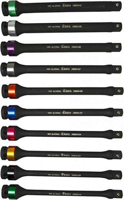

everyone saying torque sticks dont work verify with torque wrench, well I never trusted my torque wrench, cheap ass raggedy dial a setting thing. at some point you need a little gut feeling with that, to know it is close. Maybe see how loose is/isnt manually with no machine just a breaker. so I guess I should check torque setting with 5 implements and check the average to test how accurate my ts is?

im of the opinion, you need only check one lug, if the stick works with one lug it will work for all? if not why buy the sticks at all? that is the plan for me on this one.

I worked at an automotive proving grounds for a long time and we used torque sticks regularly. We did an internal study on them and found them to be very accurate. In general I would trust a good set of torque sticks more than the $20 Harbor Freight torque wrench that a lot of people are using. We also did internal calibrations of all of our torque wrenches as it was required and very important for what we were doing.
In regards to some of those comments about people getting different torque results based on the gun....sure, if you use a hi-po impact and set them and let it "ugghu-duggha" for 20 seconds it probably will be tighter, but that is also where a little common sense comes into play. You can do the same thing with a torque wrench (at least several that I have seen)....if you turn it once until it clicks, and then keep turning it until it clicks 10 more times you are increasing the torque. I've personally seen a "tech" break off head studs in a big truck engine doing this as he obviously didn't know what he was doing.
thanks brother, I like it.
These sticks are pretty stout, first time user here. Looking forward to seeing how they perform, with some secondary checks.

Okay, I'll take this bullet. I haven't ever used a torque stick. They look like an ordinary extension. How do they actually work? And are they only meant for use with impacts?
you can see each stick has a rating, just like any torque wrench once you hit that rating, it wont allow more toque, my guess it will click like a clutch. I am going downstairs to try it for first time to verify that. Gonna use a 65ft pound on my ram, my guess is it will just click.

So with my sticks there is some type around the ring, so pretty cool imo, as I am full throttle with my impact (kind violent lol) all I get was click click and absolutely no movement with that type. You know when you have an impact every click increases movement of the lug with no stick on it, there is zero movement with the 65 on my ram 130 torque. Simple test next time I will update when I take all tires off and on and verify with wrench, brake job needed soonish, maybe end of summer. Past this first easy test anyhow.
Wrong guess. Those sticks will twist like a torsion bar when the torque us reached. There is nothing to click, they're solid metal. Take note that the higher the torque the larger each stick diameter. Impact guns aren't 100% torque, it's a hammer hitting a block of metal that tightens with each hit. Once the torque is reached the stick absorbs each impact by twisting, not allowing it to tighten any further.
So you won't hear a click when tightening, if you DO, that's the sound of your lug breaking. :eek:

Maybe it was the impact clicking then, it is really hard to tell because like I said 1/2 inch impacts are violent. Thanks for clarification, the fact was for sure the type wasnt moving meaning regardless of the torque the impact was throwing at it the stick was over it's limit and was not increasing the lugs rightness.
first time using one of these

This guy uses a wrench after, for those experts if you use a 130 pound stick do you need to use a wrench as well?

Wrong guess. Those sticks will twist like a torsion bar when the torque us reached. There is nothing to click, they're solid metal. Take note that the higher the torque the larger each stick diameter. Impact guns aren't 100% torque, it's a hammer hitting a block of metal that tightens with each hit. Once the torque is reached the stick absorbs each impact by twisting, not allowing it to tighten ant further.
So is you won't hear a click when tightening, if you DO, that's the sound of your lug breaking. :eek:
That makes sense. Thanks for taking the time to explain it!
Correct. The torsion bar affect absorbs the impact and doesn't let it tighten anymore. For anybody with experience using impact wrenches you know that regular extensions and swivels greatly reduce the power of an impact because they are absorbing some of each hit of the gun. Impacts also are not very effective for trying to loosen something like a bolt in a rubber bushing (like a leaf spring bolt) because the rubber/bushing is absorbing the impact. Kinda' the same philosphy as to why torque sticks work.

well damn, this video explains it all, and I'm not happy with it, looks like maybe I use a 100 stick and finish it with a t wrench. just trying to figure this stuff out to have a safe result. Maybe find the sweet spot with my dewy 1/2 inch and know how fast the wheel is at 130 ft pounds or close with the stick, verify and just learn that sweet spot, likely soon as clutch breaks on the impact, and verify then trust it.
