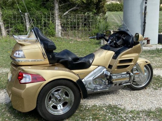

Ought to feel how a 3 wheel trike rides with roads. U just get pulled all over unless U try to ride hitting both lanes, but dat be a death wish. Either your center front gets pulled or one of the rear wheels gets pulled. Constant fight to maintain a lane, and add a cross wind, hold on Charlie lol.
OP: u do gotta find a good shop tho that does/and or specializes in road alignments and such. But some roads are crowned worse than others also.

We did some Champion trike conversions, and after enough test rides I concluded that when I couldn't hold up a motorcycle anymore, I'd rather drive a Miata or S2000.
Interestingly, with the difference in track width, duallies also require pretty constant input.

Just FYI, mine is a Motor Trike Conversion.
