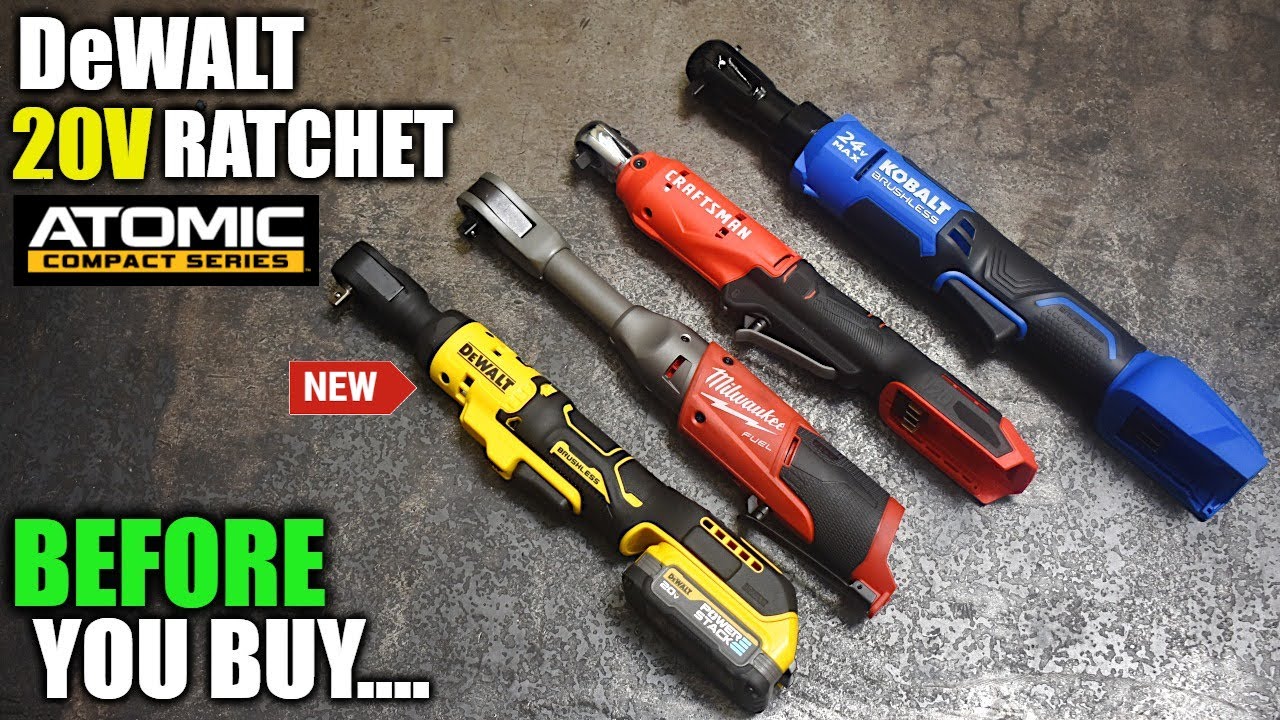

I have seen some video where 12v dewalt out perform the dewalt 20v, which totally disappoints me as I chose that platform. The ratchet was one of them.
