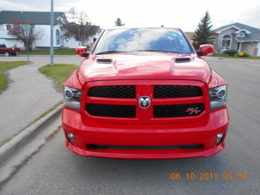

I don't think that'll open the shutters any earlier,but it'd be easy enough to check,drive it till it's at full operating temp,leave it running,then check to see if they open when the fan cycles on.I've never actually checked that operation,as i ran with most of the shutters pulled so it wasn't really something i looked into.
What grill do you have,there's a big differance in how much the differant grills allow as far as airflow goes.
My truck originally had the sport grill,and when i swapped to the honeycomb inserts,there was a differance in transmission and engine temps with the free'r flowing honeycomb inserts.
