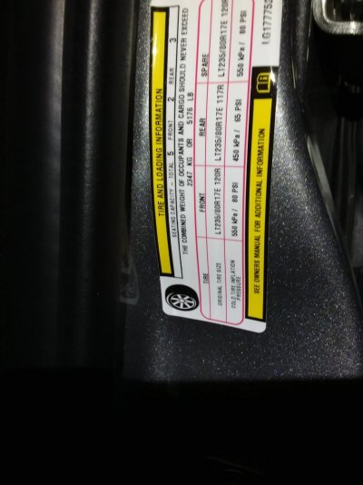

20210112_213015.jpg Nope, Im right on the money, posted 5200lb pl and that's what I've got on, also right on 14k gvwr too. I've weighed my set up at cat scales multiple times to get it just right, were full time rvers so I'm real particular about my equipment and how it's loadedn the 14k gvwr too. I've weighed my set up at cat scales multiple times to get it just right, were full time rvers so I'm real particular about my equipment and how it's loaded

View attachment 510652 Nope, Im right on the money, posted 5200lb pl and that's what I've got on, also right on 14k gvwr too. I've weighed my set up at cat scales multiple times to get it just right, were full time rvers so I'm real particular about my equipment and how it's loadedn the 14k gvwr too. I've weighed my set up at cat scales multiple times to get it just right, were full time rvers so I'm real particular about my equipment and how it's loaded

There's already a "safety cushion" in the ratings number why shy away from using it. Starting with the 2015 model year Ram is using the SAE J2807 for determining Tow/Haul capacities.
Technically over.
You said your pin weight was 5,200lbs which is your payload.
But you need to subtract the weight of passengers and all the stuff you added to the truck e.g. 30k MoparPuck Fiver Hitch w/ Black Line X Tube Steps & Below Rail Lund Toolbox and a Bak flip mx4 Cover ... and everything else.
