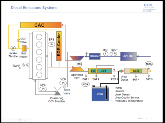

DEF is better than EGR by a long shot, and it never touches the engine, and up through 2024 the SCR is after the DPF, so there is nothing to gum up.
learned something new thanks tj, so I am wrong about it gumming the dpf.
But that also doesn't change the poor results this recall is doing. As you know any gumming is like a long term issue with any Cummins and perhaps this recall wont effect that thing that happens on short trip trucks anyway. If you see the reviews of the recall, there is a bunch of stuff like emission codes that pop up right after and dealers shrug their shoulders on it. Thanks for the info

It is good to learn the difference from EGR DPF and how DEF works, why? The clean air act which like everyone should support forces dealing with particulates. Thanks again to tj as I missed that in the video from freedom worx.
I actually have a new appreciation for DEF, now can we double up on it but get rid of EGR coolers and dpf?
EGR systems can significantly reduce the formation of NOx. However, this is less effective than an SCR system, with some older systems only reducing NOx by about 40%.
  • DEF is injected into the exhaust stream after combustion. Inside a catalytic converter, the urea in the DEF converts NOx into harmless nitrogen and water vapor.
  • Effectiveness: SCR systems using DEF can reduce NOx emissions by as much as 90%.

No I'll effects except using more DEF?
It's not a significant amount more, in fact many people don't even notice a difference in DEF consumption. And as mentioned it doesn't even come near the engine, turbo, DPF etc so it's not harming anything.
There has been all kinds of paranoid rumors over this, to include "they are locking your ECM" which is completely false. Social media (youtube influencers) just like to stoke the fire for views so that doesn't help the situation.
