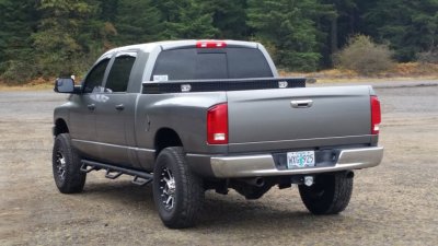

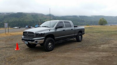

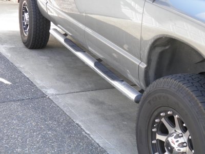

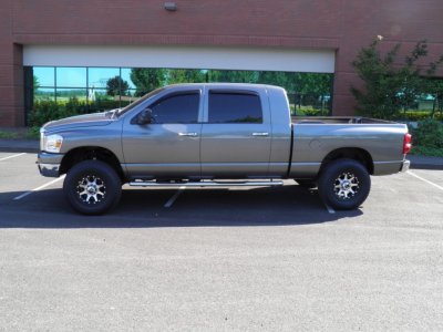

285/75R18 tires look good with a 2 or 2.5 inch level kit. A 285/75R18 equates to 34.5" tall tire that is 11.2" wide.
I ran that size on my 2007 MegaCab and towed a lot. No issues whatsoever. Here's that truck:
MADDOG
Living in a Firepit
Dec 26, 2011
15,200
11,502
Arizona
6.4L HEMI
XD Addict 795, 18 x 9, 18mm offset.
