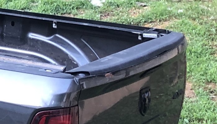

Hey all,
Was away on an ATV weekend and left the tailgate down when I pulled out of the way with my cargo trailer (see attached picture). I had no idea the tailgate is aluminum (so is the hood) therefore it is alot harder to work on. Anybody suffer the same awful fate and what did you do to repair/replace the tailgate. FYI...I'm in Ontario north of Toronto.

Yep, I called my buddy, who is a sales guy at my local dealer, to get his body repair recommendations and he told me that both the hood and tailgate are aluminum and body shops don't like to touch aluminum, if they do, it would be very expensive. Also explains why so much paint chipped off, apparently paint doesn’t adhere to aluminum as well as steel.
So I might look at auto wreckers unless someone on here has other advice.

Just make sure you use zinc chromate (green or yellow) primer on the aluminum if you're going to fix it. Regular primer doesnt stick to it properly.

I was scared to order the multifunction tailgate when I ordered my 2022 but I did. The reason is I have not had a lot of luck with tailgates. On my (now gone) 2013 I backed into my dump trailer's gooseneck and destroyed the tailgate beyond repair, I just bought a new one. I was backing my 2015 3500 to hitch our fifth wheel and I forgot to drop the tailgate and fortunately, caught it before too much damage was done. I grabbed my bottle of touch-up paint and so far no rust.

Assuming you are or will be engaging a professional Body shop (via your Insurance), they will replace the tailgate, if it is aluminum. I recently had something in my garage overhead storage Fall on the wife’s car, which as it turns out has an all Aluminum hood…..2-3 size-able dents……I went to my trusted local body shop and they told me they would order a new replacement hood - they wouldn’t even attempt to repair the Aluminum hood….

That's about how mine looked after pulling my gooseneck stock trailer over too-steep a transition coming out of a pasture - crimped the top edge of the tailgate and broke the plastic cap:
I was able to remove the inside panel and push it back out (2015 2500, since sold). Had to buy a new plastic cap, and sanded and repainted the metal while I had that off.
It ended up being a 20/20 job (looked good at 20 feet or 20 mph), but was fine for it being a farm truck. At least stopped the rust!
