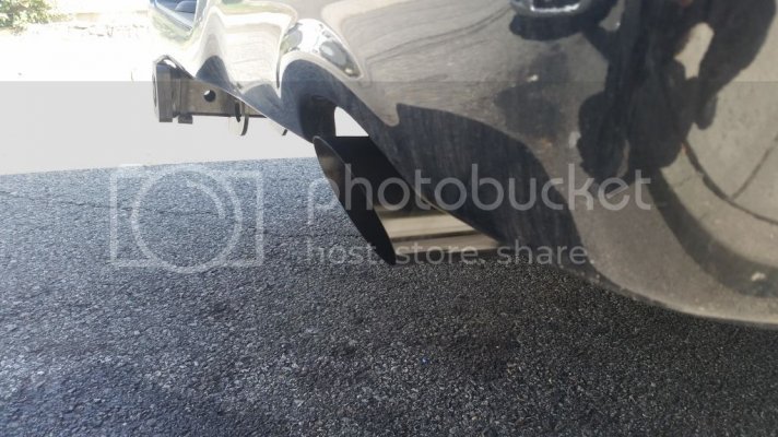

Well I spent a few hours putting in the dynomax catback yesterday… Not super happy with the fitment of the tail pipes (by the tips) and started it up last night kinda late when I finished. The driver side tailpipe fits like Poo… hangs very low like they didn't put enough bend in the small pipe that the tip connects to. I tried to bend it alittle more in my pipe bender which turned out to just crush the pipe…. ugh.
Good news is that the exhaust sounds good, cold start seems slightly louder and deeper (larger pipes and no resonators i assume). But revving it seemed quieter in the cab. I haven't taken the truck out to drive to check for resonance yet but just wanted to update this thread.

Yeah, thats why the DYnomax is so cheap. I had the same issue on my JGC, tailpipe fitment was awful. So bad that I drilled a new hole in the rubber connector holding it just to get it to line up.
It actually sounded very good though on my JGC 5.7L and I took it on a 2400 mile trip without having any drone.

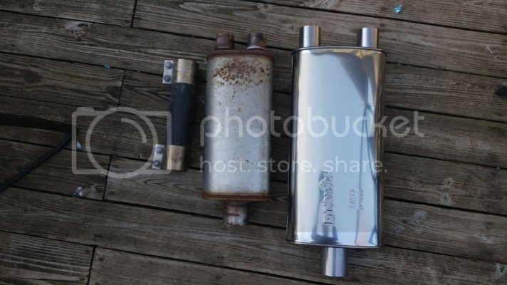

Its not that bad. Honestly maybe 1" or so from the bumper cutout. Pics look funny bc of the black tips and the shadow but it doesn't look all that bad. Hope to get it out and see about resonance and drone. Also posting a pic of the muffler difference… quite a bit!!! Don't like how the dynomax isn't fully welded tho.
Here are some pics.
Muffler size comparison
