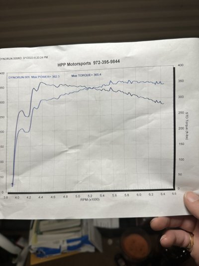

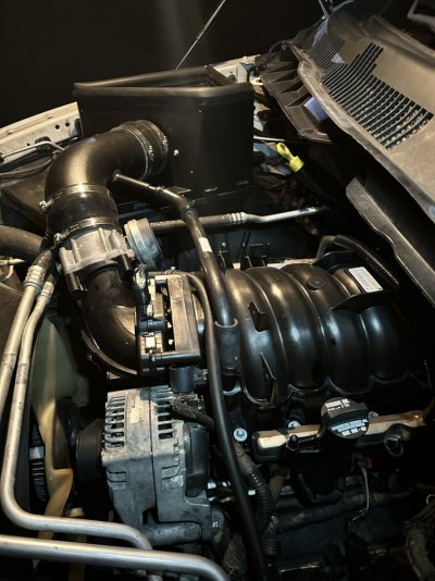

Dyno results, runs like crap 363 hp 2011 RAM 5 speed. Why is my truck slower then stock. Does this dyno graph look bad
Scomer412
Jan 3, 2022
79
40
Royse city
I just had HPP PERFORMACE out of Dallas do 6.4 intake, long tube headers, TSP stage 1 cam, off road y pipe and stock cat back exhaust on 89 tune.
super slow, is it tuned wrong or did they mess up the intake system install. I spent 8k and it runs like ****. Please help with opinions.
Steering column runs headers and is dangerous to drive.
I mean the steering column rubs the bumps the headers. Sounds like there is a exhaust leak. What are your thought

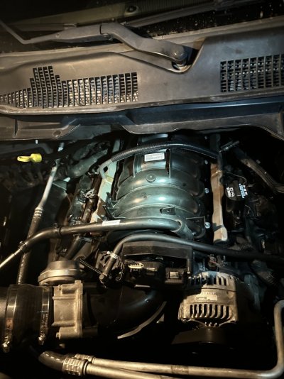

Could be lots of things.
Your stock Converter is the weak link followed by the ****** trans .
Did they tune the trans ? Why are you tuning on 89 ?

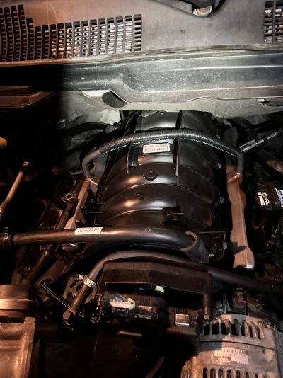

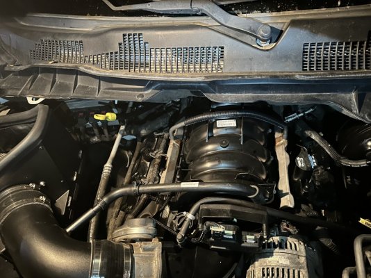

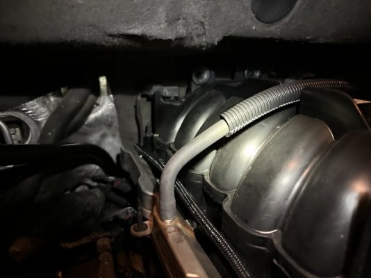

What kind of performance shop routes the hose back to the intake on a 6.4 manifold... Pull that crap off and put on a breather.
The steering rubbing on the LTs is something lots of us had to deal with. Nothing a hammer and socket couldn't fix. But for 8K that **** should've been dealt with before you got it back.
But what do I know im a certified backyard youtube mechanic... lol...

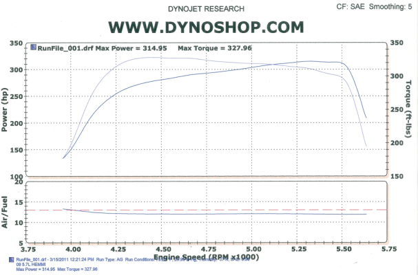

I thought 5.7 rams with the 5 speed only dyno 300rwhp, 330 for the 8 speed? You're making 63hp over stock to the wheels swap an 8 speed and you gain another 20hp. The headers rubbing the steering column could be triggering the knock sensors to pull timing under load.

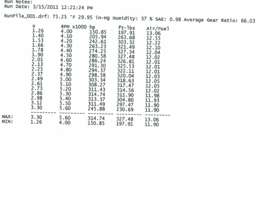

just looking at the dyno sheet i can see they messed up the tune and they are trying to blame components.. That should be a nice clean line curve like above not a choppy mess like the one they provided you.. The truck should have never left the shop or been paid for until they fixed the issue. They must not care about their immage to let something go out the door running so bad
