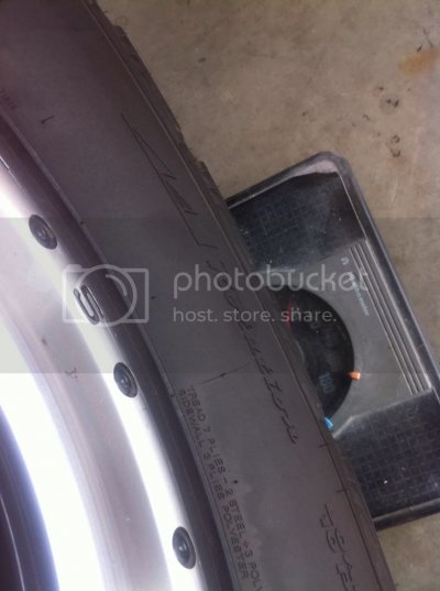

MoparMan ...
Wheels are 24 pounds each 16x8
Tires are 79 pounds each 315-75-16
So each one weighed out on the scale with air and weights at 116 each

Perfect...
So I'll show you something now...
Rule of thumb: For every 4 pounds of rotational mass will require 1 HP.
So like mine are 62# for rim, tire, air etc. Your are 116# per tire...
62# x 4 tires = 248# total
116# x 4 tires = 464# total
Difference of...
464# - 248# = 216#
So now the rule of thumb...
216# / 4 = 54 HP
So you require 54 more HP just to keep up with me on the pavement. So since I require 54 HP less to keep rolling vs you my MPG's will be greater...
Some thing to chew on... No personal attacks here but to point out the larger tire on these tire do look great but they come at a price for the tire and the constant loss of MPG's. As for using a percentage to correct I find more time out of ten that doesn't math out right. But if you use a GPS and gallons you might find a true story.

I am not worried about the 54 hp loss as I will gain that and some back with injectors , new turbo , gears , ect ,,, And I am still in the low 20's for MPG .
I am happy

Edit ,, I take that back .. wife said the scale I used was broken
Got another scale 98 pounds each

See I had a effect on you... :naughty:
Now you at least looking at rotational mass as a possible facotr to performance. That good at least now you not letting simple stuff get by you. :)
