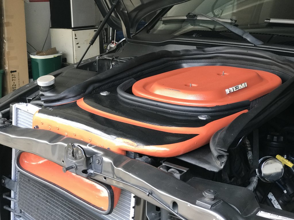

Love my Vararam, wouldn't take anything for her. It does make a difference and a lot more with a programmer.IMG_0209.JPG

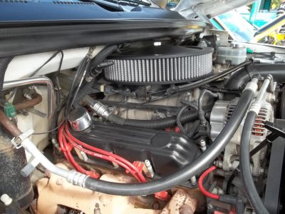

Hey Pepper9...
Don't cha just love it when the guys with newer trucks get in here and try to recommend stuff for the 5.9. Stuff that won't even fit on the TB.
It's like they don't get enough attention in their own forums.
Vararams won't fit the magnum...period.
Plastic cracks.
Aluminum bends.
Steel rusts...powder coat it.
Both heat soak but at different rates, You would need a lot of really cool air from an outside source shoved into the element to build power from just an air filter.
Any filter smaller in area than the OE element loses power. If you must run a cone filter you need one at least a foot long, 4 -6 inches in diameter at the base, and an inner cone on the front end.
You will feel the power decrease when the filter starts to get dirty. You will also know because you cannot hear it anymore.
Pepper hates it when I post this. but it's as cheap or cheaper than a chinesium ebay tube. And I have about 12 years run time on it, so I know what it does, and what it don't.
And if didn't I'd have gotten rid of it. But I got rid of a FIPK and got this.
