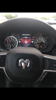

So I installed an edge pulsar 5 k miles ago and the first 4k it worked wonderfully and the truck ran great. However the last 1000 miles, something weird started happening.
Seemingly every 100 to 500 miles, Sometimes less (50 ?) Numerous warning lights on the dash go off, the truck becomes sluggish but still drivable. Once i turn it off and back on the warning lights (forward collision, throttle sensorr, stability cobtrol, cross path light and front and back sensors) all turn back off and performance is restored. The check engine light remains on for 20 to 30 miles and then eventually turns off as well.

I have the new unit that I am going to install in a few minutes.. I had the warning lights all over as well but they claim they have fixed it. we will see in about an hour....

I had the same issues. I went through four units before calling it quits. The last time it started to accelerate on its own. No good. 7B871AD0-D584-47E6-AF77-458B555F43B0.png
