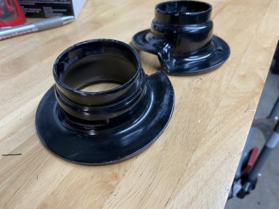

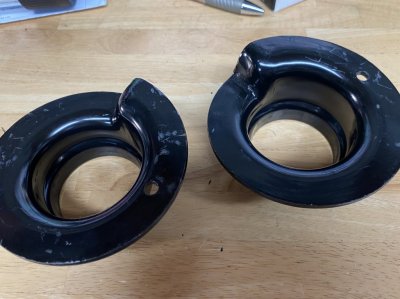

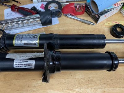

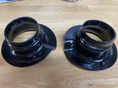

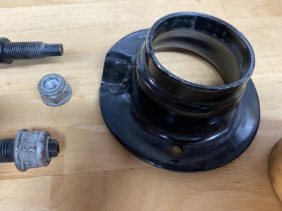

With the OEM struts, you turn the strut upside down , then take a hammer and tap off the strut end cap near the shaft end. Then take the hammer and tap around the spring perch till it falls off (if rusted some spray lube helps)
If they are aftermarket then maybe they are tack welded on, without seeing them we can’t determine that.
My Bilstein 6112's include billet perches so I still have my oem struts. I removed mine for you, here’s a few pics. I can sell you these if you want them.
