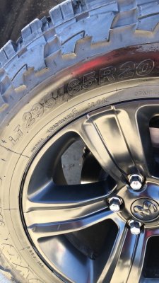

Wow major eff up on the dealer when I picked up the truck today. I went to wash and clean my wheels I noticed the tires on the rear are off size. Like big time
I live 100km away and they are closed until Monday morning. Should I be safe for now on my diffs?

So you have 3 295s and 1 275?
Do you have the anti spin rear dif
