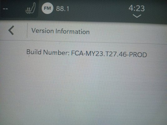

It would be under the Vehicle icon then 'Settings" then "system information", is either a "T' level software or a "U'

Hello,
What is the software level of the module?
Here it is:
