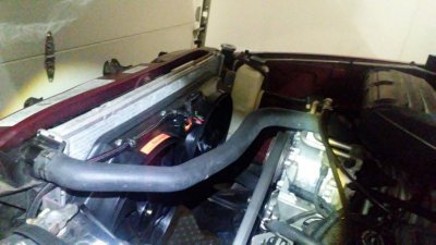

I just converted to an electric fan from Flex a Lite a few weeks ago. A bit pricey but it comes with a nice controller that works very well. I recommend 120 amp alternator because the draw is 36 amp at 100%. The stock 90 amp may handle it but the draw could be too much. There's a direct fit for a diesel that includes brackets for coolant overflow and windshield washer tank. I think it will work on the gas but didn't want to take the chance. I had to make brackets to mount the fan and overflow tank. Still need to mount the windshield washer tank.
