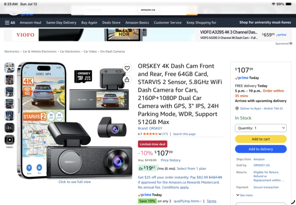

Buy one of these. Attach it to your headliner, seat, or door so it can see the cluster and tach. Hook the small one below you it can see where your feet are. You will now have proof to show the dealer, or lawyer.....
This is a good idea, but I think a OBD-plug data-logger would also be very beneficial for diagnosis. It would be a good combo to have all these items installed............... for a variety of reasons.
