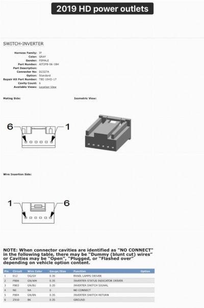

The connector for the inverter switch when equipped.

You wouldn’t have the switch itself. It is for the power outlet inside the driver side ram box if equipped.
Ahhh, gotcha. I thought it was for the inverters in the cab.
Totally makes sense!
Thanks!
