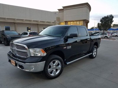

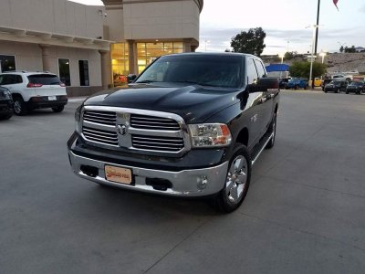

So first thread ever here. Got a 2014 Lone Star and absolutely hate the chrome so I've slowly been eliminating it. Started with the grill, got an unpainted grill and painted it black and swapped the chrome inserts out for the honeycomb inserts off of the sports. And had to figure out what to do with the bumpers. I've seen a lot of guys on here wrap their bumpers but I wanted something a bit more durable and longer lasting decided to give powdercoating my bumpers a shot. I'd say the results speak for themselves what do y'all think? Here's some before and after pics.

Pretty sure they sanded prepped and powdercoated. But I don't believe they de-chromed the bumpers. It's been holding up for a couple of months now though.
