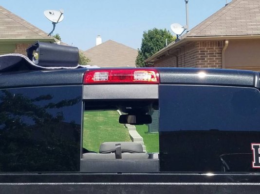

1. Remove 3rd Brake Light(2 Phillips screws) and disconnect single connector to truck.

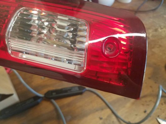

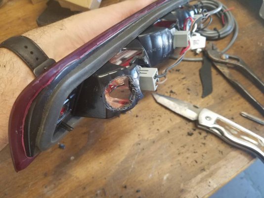

2. Drill a 1" hole(2nd pic) in the side of the housing next to the existing light, as far over as possible as to stay away from the existing bulb seat. It's a close fit but it works (1st pic) Take caution to shake all of the drilled plastic out of the housing(maybe that's my OCD, 3rd pic).
3. You may need a knife to trim the plastic in some parts depending on what kind of 1" blade you use. Insert the flasher in the newly drilled hole with the rubber grommet first and then align the two screw holes so they both will go into the housing.
4. Repeat for the other side.. drill the hole, shake out the plastic, and attach the other flasher.
5. Run the wires through the brake light hole and let them come out of the ceiling straight down. I opened my rear window for this so I could do everything from the bed of the truck. If you push the wiring straight down, it will separate the ceiling liner as minimal as possible. Pull the wires all the way through into the truck and reinstall the brake light.

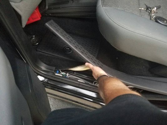

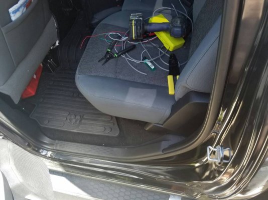

7. Run the wires under the ceiling liner and down the rear pillar to the floor and under the kick panel on the floor. You're going to want to try and remove or lift up as much as possible the kick panel on the driver side floor because that's about where your wires will end.
8. I used a torx driver to remove the floor pocket too because it let me lift up the carpet more and work under there. Attach the green wires(sync) together, the black wires (ground) and the red wires(power).
9. Put a single ring terminal on the black and use a self tapping screw and drill into the body under the floor. I used heatshrink on the green to cover them and hid them away. Connect the two red to a single wire about 10 feet long and feed that towards the driver seat, you'll get to that soon. Now the white wire is for programming the flash pattern so you'll need to get to them any time you want to change the pattern, so I used two small wire caps and put them away also. Tuck all the wiring under the carpet or under the rear of the kick panel, but don't put it all back together yet. In the pic, you can see the heat shrunk wires, ground, capped wires and wire tap on the power (explained later).

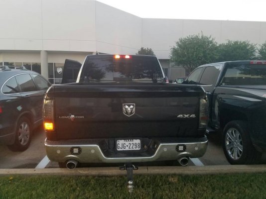

11. Once you have the power wire ran, turn them on and test them. It's hard to tell with the way the light was hitting but they're going.
https://vimeo.com/180251969
https://vimeo.com/180252601
12. To change the pattern, you need touch the white wire to a power source for a second. Each time you touch the white wire to power, it will change the flasher pattern. It will outline it more in detail in the instructions with the light. I installed a wire tap(see on the left side of the pic in step 9) so I could tap into the power for later programming(they have to be on for power to be on the red wires to touch to the white). I kept switching the pattern and checking the lights but it'll be much easier if you're in your garage or do it when you're able to see the flash pattern reflecting off something so you don't have to walk to the back of the truck each time.

I tried to mount them as close to or in place of the original lights as per the instructions to maximize the use of the factory housing reflector. Worked very well with the lower set, top not terrible but with the limited space, I did what I could. Since I'm home now, here's one more video at night to see the full brightness.
https://vimeo.com/180256955
