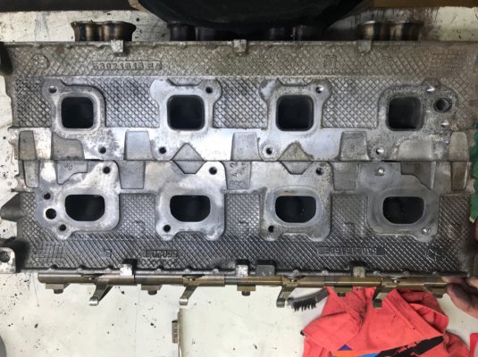

That might be close, that’s what my truck has right now, stock heads and custom stroker cam. After all that I’m alittle underwhelmed with the power, and I feel like it’s mainly held back by the small heads. I would suggest trying to find a set of 09+ 5.7 heads. Just bolting them on will raise the compression way up, so plan ahead and get a dished piston to lower the compression ratio. I went with a -1.5 flat top and wished I would have went with a -14 or so dished. Now I’m going to need a thick head gasket to bring it down to around 10.8. I’m going full blown and adding an 09+ truck intake manifold as well and see how that works. The only issue is getting headers since the newer heads have a D shaped exhaust port while the old heads have a square port. But since you are considering retrofitting into an older car you might have a better option or just use some shorties 2bf3a4190d25f353658340213584d010.jpg

Those are pretty good numbers, definitely makes it worth it to get these eagle heads installed. Did you run his cam as well?

That sounds like a lot of fun. I really want to spring for the 6.1 manifold cause they look awesome, but they are too damn expensive. I’m going to try the eagle truck intake and see how it runs, maybe upgrade to the 6.1 later
