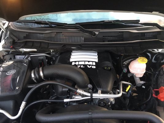

Engine cover mod...looks pretty good

As far as I know you can paint/wrap anything thats plastic/metal. You CAI cover, tube, fuse box cover, all the fluids caps..etc. I dipped my engine cover in my Charger black and red. But I always forgot to clean it lol

Billet tech "Under Hood Dress Up Kit" and paint fuse box top to match your engine cover. Cover looks good!!!!!

Looks really good!!!! I like a nice well kept engine compartment.

Nice ! How do you like the volant Cai.

Cover looks good. Have you considered painting fuse box covers red? Maybe sleeve the A/C & coolant hoses?

Looks good, OP.

At the OP , That looks awesome !

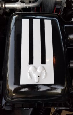

Want to do mine too-do I just remove cover,clean with alcohol and can I just use exterior enamel spray paint or do I need special high-heat paint. Don't want to start until I get a your guys advice--don't want to end up with a big mess-or much worse a fire under the hood!!!
I’d like to paint a lot of parts under my hood...

On my airbox, lid, fuse box cover and air intake scoop to fenderwell....
Removed, washed, light sanded with 1000 grit to remove anything stuck on, washed n dried, cleaned with denatured alcohol and sprayed away. Used high heat paint just cuz and clear coated.
Painted air box(black), airbox lid 2 colors(black and white,pain to tape up top of cover), air inlet tube (white) and fusebox cover (white).
Dont look at rams head nose too close...lol thats going to be fixed on phase two

Notice on 2nd pic engine cover not on? Wonder why? 2 tone painting is time consuming and taping is sooo important,(note the ram's nose)!
Prep is EVERYTHING in painting, clean the hell out of it. I learned the hard way by cleaning, alcohol wiping, spraying and got fisheyes in the coats so wet sanded down to remove whatever was there and whala
