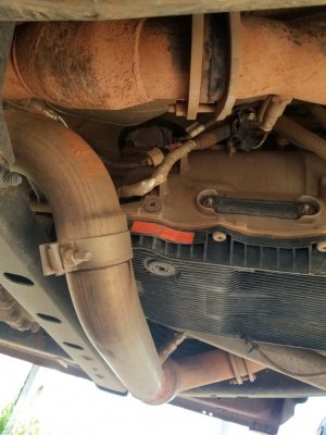

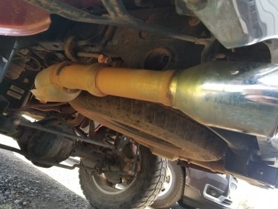

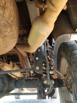

So this is going to sound like a complete bonehead question, but I just purchased a 2014 Dogde Ram 1500 Laramie with the 5.7 hemi. Within a couple of hrs of driving the check engine light came on. It seems to be running fine....no issues at all. All the gauges work, rechecked the gas cap....since I filled up a few minutes prior, and all fluids are good. I went to the dealer today and they checked it out and found nothing wrong either, but he did notice something that I suspected about the truck. The truck was fitted with high performance headers and the rest of the exhaust was modified for performance as well. (The state of Oklahoma has zero emission laws) He said he sees it all the time. He said it's fine, safe and not to worry, but I should fine a performance shop that can tune the truck so the engine light will go away. He stated that it's not something he can do. I attached a couple pics of the exhaust. Any opinions?

Looks like high flow cats.. probably a code related to the system thinking the cats aren't working. I bet that system you've got there is loud.
It's got a bit of volume especially at startup or if I put my foot down, but it's really not to bad

I bet the truck was tuned and had a few more bolt ons before the last owner sold.
the code is probably a rear o2 sensor malfunction code, might be 2 codes stored. I can’t tell if you have rear o2’s from the pic but it looks like you don’t. the tune probably tricked the truck into thinking they were still there
^ This.
