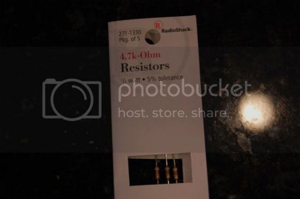

4.7k-ohm 1/4 watt resistors from radio shack

resistors

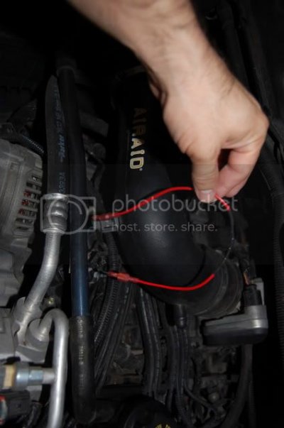

finished product
installed, note wires are too long i cut them shorter

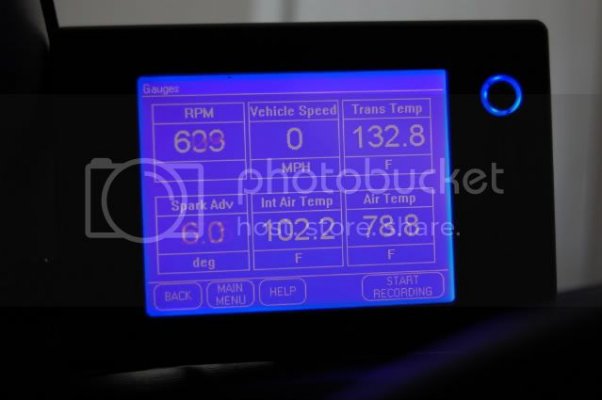

before(check the IAT)
after(check the IAT)
