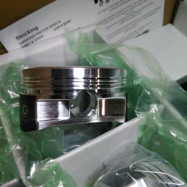

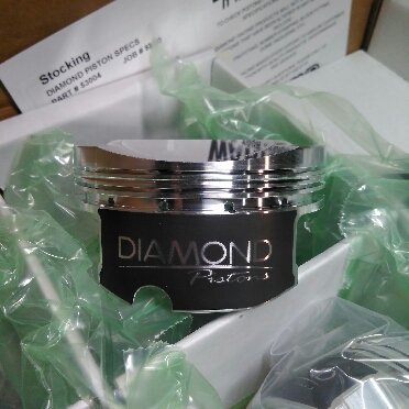

Will bring the haters along for the ride during this project. Godfather racing out of Fraser Michigan and myself are doing build. e39d2ed8dfb683067c9f2a958a298581.jpg71199d5c92f959fc3b612d2e41c3e92d.jpg98389036d4954ef2f802a1bb8fde1813.jpg14f11e7eb8e23b9168b686c32d5a54d2.jpg520533e556fe915d60eb15c1249e8bf7.jpg

Pretty pistons.

Sure are pretty pistons. Shame to get them nasty.
