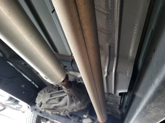

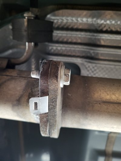

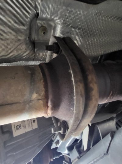

I had 2 bolts broken in rear muffler bracket which the dealer blamed on rust, even though the mechanic left the cause for the failure blank. If you look at the pics, there is no significant rust under the truck. I work very hard to keep it that way. I would like to have this repair covered by either my standard warranty or the Federal Emission 80,000-mile warranty, and I have been trying to escalate this matter but customer service at Stellantis has been nonexistent, I have been trying to get a response from them through various channels, even registered mail but have received only silence. I bought my first Ram 1500 from my dealer in 1995, and this current truck is the 5th Ram I have purchased since then. My wife has driven only Jeeps and is on her 4th. It's a shame I am being treated this way after my history of customer loyalty.

In picture #3 the nuts on the bolts look rusty enough that they would likely break if someone tried to remove them, regardless of the cleanliness of the underside of the truck.
