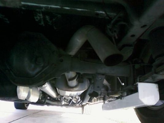

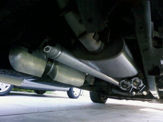

pics..pacesetter lt's, gutted cats, H pipe, dual cutouts, di/so muffler.. my system is both welded and flanged...
I can make it smog legal by putting stock cats back in and clamping on a tailpipe
smog legal shortys with stock cats
