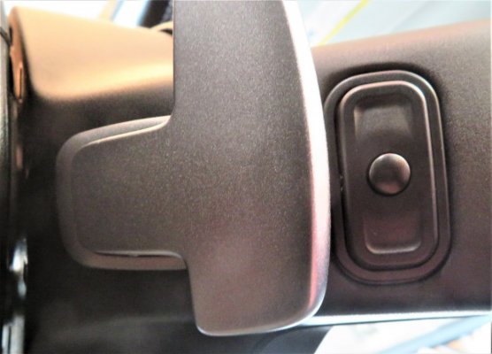

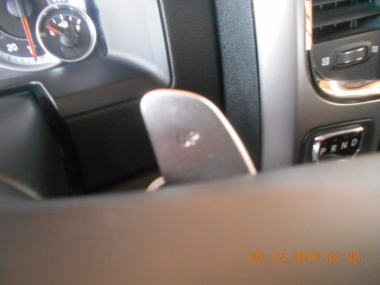

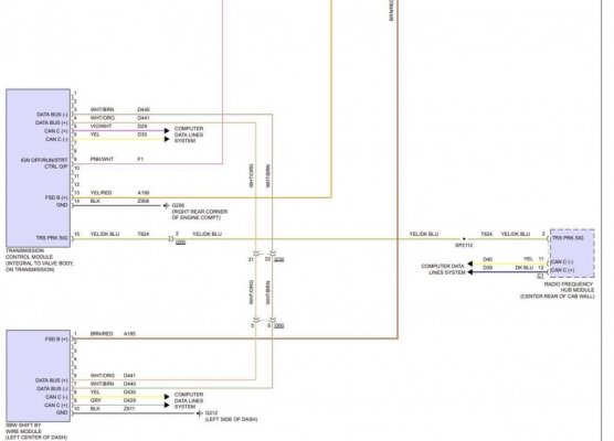

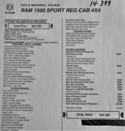

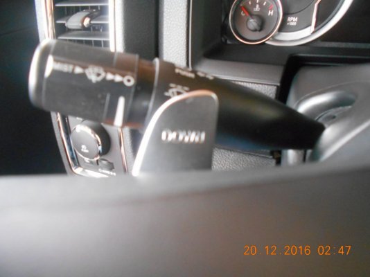

I will look into this once I get these little alfa obd programming issues out the way.
Could use some help with why the bottom panel with all the buttons won’t light up? I have the connector in and I don’t know what the name of that would be to enable it in alfaobd the other part was I was reading about the 2013’s heated seat controls on the screen greyed out. Is there a fix for this? I wasn’t able to find it, maybe y’all know & my interior mirror dims but the little green light button between addis and 911 won’t light up. I have all the connectors and hardware I even enabled the options in alfaobd, it dims but the microphone for bluetooth no longer work and it did before I used alfaobd on it
That i can't help with,my regular cab 14 Sport has pretty well every available interior option you could get on a regular cab in 14,so i've never looked into adding any interior options to it.If it doesn't make it go faster i'm usually not to interested in adding it,lol.The only thing i've added are paddle shifters,and i have to give that credit to my buddy who built a few of them back in 2015,and he installed them for me
