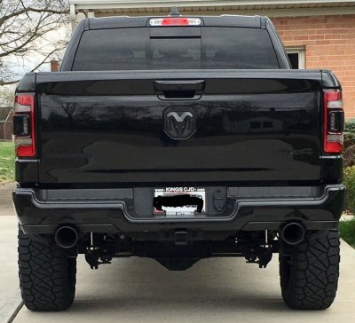

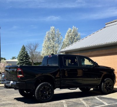

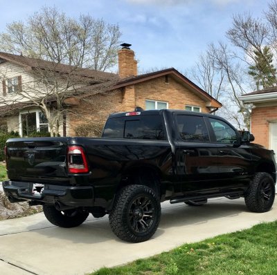

He said it handles at least as good as stock possibly slightly better, had no problems with any sensors and no rubbing after the alignment. He said the rear end feels loose so I went through and retorqued the trac bar and he is out testing it now. This kit was very impressive, the quality is amazing. It did take all weekend to install but it’s worth it. He did the performance kit with dirt logic coil overs and rear shocks.
It feels pretty damn good now! I can't thank you enough for your help!!!

Brave man cutting the frame on a brand new truck! Looks good. Congrats.

Thanks man! Yeah it gave me the night sweats thinking about it. It came out great though!

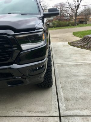

Truck looks really nice, so how much actual front and rear lift did it give?
Thank you! Well we did measure at the wheel well before, but unfortunately we did not write it down or remember it. I'll have to find another 2019 like mine and measure it. I can tell you that I'm at 43.25" in the front and 45.5" in the rear after the lift at the top of the inner wheel wells.
I think it was around 35” front and 37” rear so the kit is extremely close to true 6” of lift, he also switched from 31” tires to 35” tires.

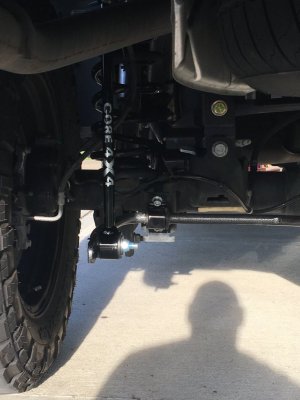

Added the Hellwig RSB today. Riding and handling like a dream! Core 4x4 End Links coming Monday!
