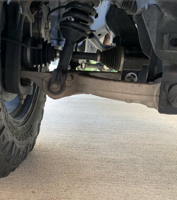

Well done sir, and those angles are looking good!

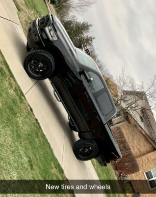

Btw, maybe I missed it but what was the offset on your new rims and do you know the oem 20" offset by chance? I'd like to put 22x10" rims with a 35 tire how much clearance do you have on full steering lock left and right on your setup?
