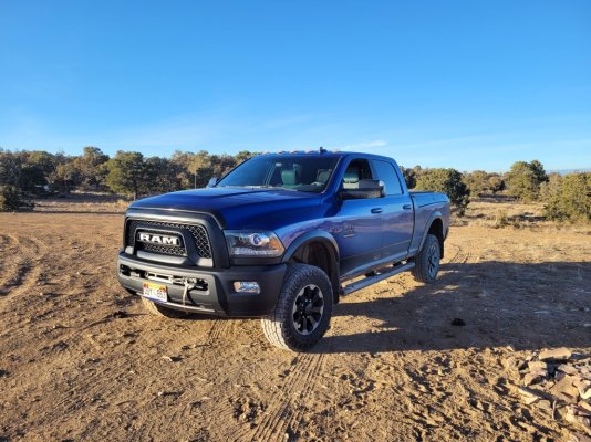

Well I have lived with my 17 power wagon for 6 months now. Love the truck. I'm finding all the things I would like to do to the truck however. Exhaust, tires, brake upgrade, g56 swap (eventually). I want to put on board air in the truck for airing up tires and the future bags. My dad has a rebel with the air suspension. That setup is so quiet. Has the factory setup ever been used for what I'm looking to do? Obviously I would need a controller and make up a few brackets but is it doable as far as operation goes?
