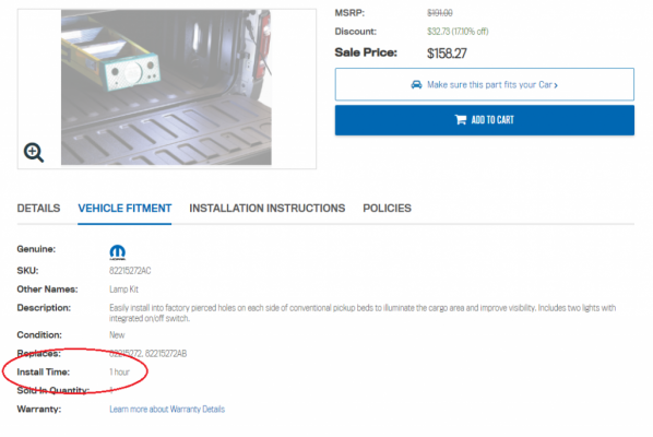

Actually found this tidbit of info directly from the Official Mopar parts website. 1hr install time. Funny my dealer quoted more than twice that. Seems kind of shady to me.

Take the Mopar parts list with the 1 hour install time and ask your dealer to honour it. If they won't find a dealer that will and do all your service and other work through them from now on. If your current dealer will grab you for this small job, imagine what he will do on larger ones. I used to do pretty much all my own work because I enjoyed it, but last few years I have been way too busy to do it myself. Started checking out dealerships to service the vehicles still on warranty. Took me a long time to find good dealers to work with but I have now found 2 locally. Makes a HUGE difference. They will also be where I buy my next vehicles from.
