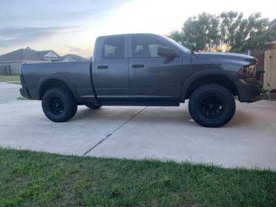

Offset on most if not all factory rims across all sizes and trim levels is +18 to +20 and as previously stated above, wider and larger tires will rub suspension parts as well as fenders and front bumper. A 17-18” wheel with a 0 to -6 offset on 35/12-5” will look great (ask me how I know ;) )

Your truck looks great. Can I use the factory rims and 35"'s if I use a spacer?

Yes you can. I was doing the exact same thing prior to my new setup. Let me know if you need spacers as I have a set for sale.
