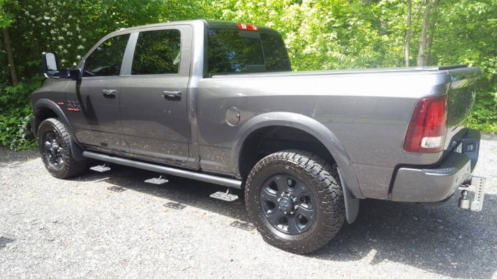

I run them in a 35x12.5x20 all stock suspension and wheels. Ive had them on for about a year and have 21000+ miles on them with 5k+ of that towing a 10k+ lb trailer. Ive rotated them twice in that time. They are quiet, have excellent traction and are wearing beautifully. I will absolutely buy another set when these wear out.
Im normally a BFG guy, but tried a set of KO2s prior to these and was very disappointed. I still have the original KOs on my two other trucks and they are great tires. The KO2s wore very quickly in back while towing. I replaced them at 7k with these ATWs.69ea8de09923fa88f4eb7eeaa1455c46.jpg

There it is - Those are some good reports

That is a pretty good report. Thank you! I experienced rapid wear of my stock tires on the rear in the first 5k miles or so while towing my camper about once or twice a month. I rotated them and they dont seem to be wearing as bad right now but traction on anything other than dry pavement sucks. Man you drive a lot to put 21k on a truck in a year plus having 2 other vehicles.:favorites13:

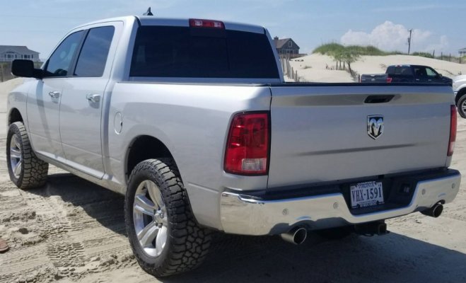

305/55/20
Tow a 9k RV a few times and no issues. I am looking into bilstein 5100 to firm up the ride for daily use and towing sag
Anyone have the bilsteins? And towed with them? 13ba9dfc8d2f4cc23fd563e414e09f2d.jpg566997cd69a174097269ee7f5cf54143.jpg915d6e02930330d03c42bc76106fb440.jpg

That's a 1500 that comes stock with P-Metric tires though. My 2500 came with Load Range E tires with a load index of 125. The 305/55r20 is a load index of 121 so no local tire shops will order or install them for me. Damn lawsuit happy society.
