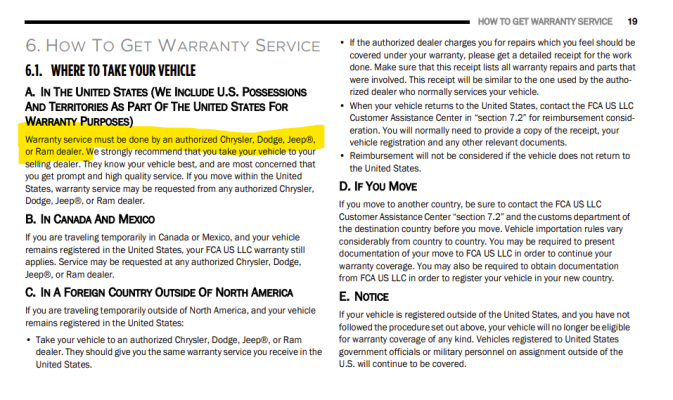

Thanks for that. I am currently on the phone with Dodge and they are claiming that even though the warranty is 100k, I MUST take it to a dealer for the repair. I think that is not correct and can find nothing that says that in the warranty info. Now they tell me it is deepen the "procedures" manual from Stellanis.
So there it goes.
They want me to button it up and take it to a dealer, but I cannot do that as he had to lift it to find the leak site.

For repairs covered under the original factory warranty you need to have the repair performed by an authorized Mopar dealership service department. It it was a 3rd party extended warranty you don't have that limitation.

You HAVE to take it in for warranty work. They're not going to allow you to fix it in your garage and send them a bill. I agree that now it looks like you're going to have to eat it.
The emissions warranty was reduced in 2017 down to 5/60k miles.
Page 6 of your warranty paperwork.

Again I thank all that have helped me with this problem in the Forum. Live and learn, although at 80, you'd think I had :(
lambert182 saved me a ton of money by pointing out the recall that I forgot. And sending the document that I could not find about warranty repairs.
Yes, I will eat it and get it done by my mechanic. In talking with another Dodge dealer service manager, it was not crystal clear that this leak would have been covered under warranty, even though it originates on the block. I would have had to agree to a $295 diagnosis before teardown.
