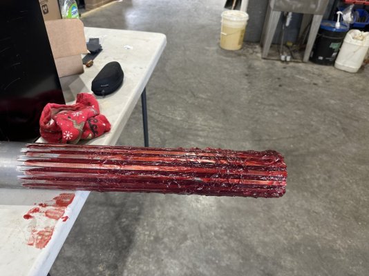

I’ve had two different mechanics check out then joints, and they confirmed that they were fine.
Googling the issue, it turns out that people experiencing the same have greased the drive shaft slip yoke, and the issue disappeared.
So I got some red tacky grease, removed the back half of the shaft, and greased the F outta the splines.
I’ve only driven it a little since doing this, but the clunk seems to have disappeared.
I’m posting this in case someone having a similar issue stumbles across this thread.
