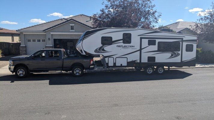

Yes you can do it but the truck doesn't like it. I had a 1500 Sport ultra short bed towing a the Keystone 23MLS. All the numers work but, as all the number crunchers will tell you there is no way to keep the pin weight under the load limit. I had airbags which helped a lot and maybe got me up to the 2000 lb payload I was running, maybe. I loved the Truck and bought the smallest Fifth wheel they make to replace a small bumper pull I had. It really did fine over the 3000 miles I ran it. I always had in the back of my mind that I should upgrade to a 2500, but I wasn't uncomfortable running this setup. The truck did everything I needed and it was paid for. The only thing I didn't like was when you went over a bump it would bounce a few times. Kinda like driving a basketball down the road.
In November I got t-boned and that was the end of the truck. Fortunately the truck was the only casualty. I took the opportunity to upgrade to a Rebel 2500 with fifth wheel mounts and a payload rating of 2964. I still have to get a hitch so I haven't towed with it yet, but I can tell it will be a whole different experience.

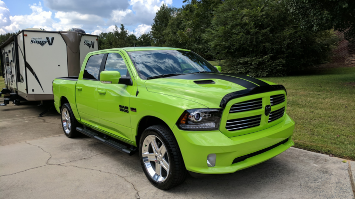

I miss my sport. Was stupid fun after whipple and tune. But, man, it did not tow my travel trailer good at all. I don't know what your payload was, but mine was ridiculously low at 774 lbs. Mainly due to the 22" wheels. I bought a set of the 20" like you had just for some peace of mind.
Yeah, I couldn't have 4 grown men in my truck without being over payload. LOL

Payload is just GVWR - Curb Weight, all wheels and tires sold on these trucks have far more than enough weight rating that they are not the limiting factor in any way.
No, they do not. The 22" sport wheels on the 4th gen's did not have the load capacity. The wheels themselves were not rated for the weight. I called FCA to question the sticker on my truck and that is what they told me.
If your statement was true all Sport's would have a 700-800 payload. They don't, because of the wheels they come with.
Same truck as mine with the 20" wheels had a payload of 1400-1500 lbs.
