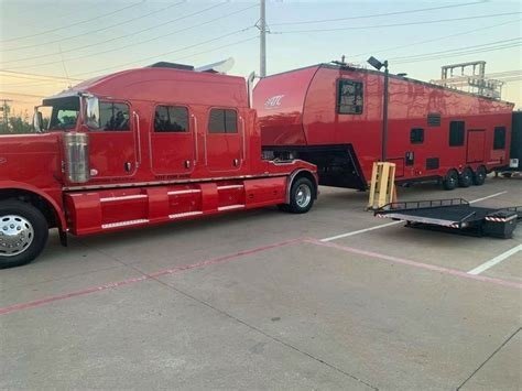

Okay but that's actually a REALLY good photoshop.
To the broader point, though, every vehicle has its limits, and while those limits are typically only enforced on COMMERCIALLY USED vehicles, they're still a good guide for non-commercial use. It's just plain not safe to tow 12k behind a half-ton truck. It's not safe to pull 25k behind a 3/4 ton truck. It's not safe to pull 34k behind a 1-ton truck that isn't properly equipped. Will it do it? Yeah, probably. Is the truck going to like it? No. Are you over on basically all of your ratings? 99% chance yes. Will it blow up when you put it in gear? No.
But what happens when someone cuts you off, or wipes out in front of you? Your brakes aren't designed to stop that much weight. Your suspension isn't designed to handle that much weight and your control is compromised. If you don't hurt someone, you'd be lucky. If you don't damage anything, you better go play the lotto or something.
Look, I'm all about people judging their own risks and acting accordingly. But when your actions start to impact the safety of others, I'm going to tell you that it's not a good idea, and that you really need to think twice about what you're doing.
