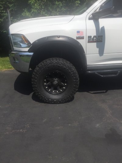

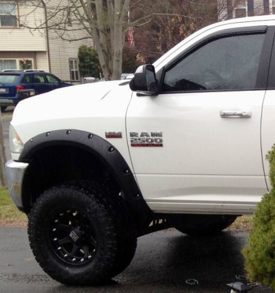

After 3 years and almost 40k miles with the 5" RC lift and 35's .... I replaced them with Cooper SST Pro's 37x13.5x18 last week.
The pics don't give you an appreciation of how big the truck sits .... but one thing is for sure, they don't look too big on the truck.
The 3.73's gotta go next tho .... decided on 4.88's after reading different forums and running diff gear calculators.
My rims are 18x9 -12 back space and I did have trim the pinch weld a little along with the fender liner.
Rides great, power and stopping feel fine but def want to regear next.

Looks awesome man. I'm on the fence between a 3" and 5" lift. Do you have pics with the 35s so we can see a comparison?
