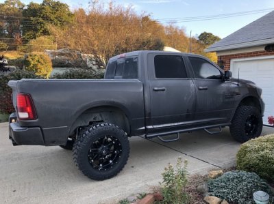

Can’t say I got it cleaned today but I did finally decide on the black honeycomb instead of the sport chrome

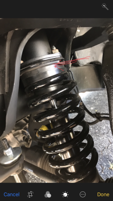

Here is what the zone preload spacer looks like for the 6” lift
It’s about 3/8”th thick

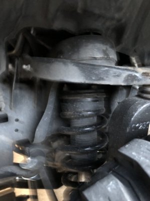

Looks like I have the front spacers installed, which may be why I’m sitting higher in the front than I wanted to be IMG_7221.jpg
