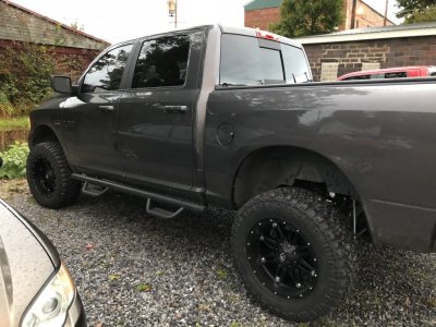

Finally got the lift on, it is literally undriveable so it's at the alignment shop now. On the way over I realized just how off the shift points are and I'm only running 35's. Is anyone willing to lend me a programmer so I can get the points set? I'd rather save the $200 and get a decent tune in the future. Here's a little teaser, I'll update as I finish it up.

Thank you. I just got a call from the alignment shop. I guess the shop that installed it did something with the tie rod ends. I was driving and didn’t understand what he meant but he said he needs the factory ends because he thinks they replaced the uppers when they should have only replaced the lowers? Something about 4 degrees of toe out and he can’t adjust it as is. I’m, needless to say, not happy
The zone tie rod ends require the installer to cut off 5/8" off the inner tie rod

its possible they didn't cut the inner tie rod and installed the zone outer tie rod and whacked out your geometry. My zone lift aligned with no issues

@MadGumby
New tie rod ends will require the
trimming of the male tie rod end.
Thread the new tie rod ends completely
down once installed. Secure
the jam nut. 2016-2017 models
have may reuse the facotry jam nut
Remove the factory tie rod ends. Trim 5/8" from the end of the male thread on
the tie rod end. Clean up the cut edge with a flap wheel.
http://4x4media.info/instructions/zon/D2612.pdf
On page 16

You guys are incredible. That was the issue. This shop figured that out just before I read this so they were on it. Now we’re back in business. Picking it up this evening.
