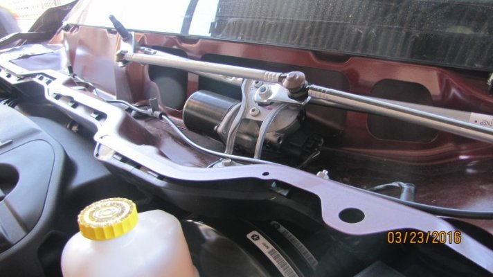

Take the Glove compartment doors off
You will then be able to see the ********* heater box, you should also be able to pull the right foot kick panel, that allows you to see the radio antenna.
If your hood is open, you may see sunlight
If not, then measure both under the hood & around the Big heater box, there should be a place to drill without damaging something
If you drill high, then you would be in the cavity where the windshield wipers reside :)

984B1650-B9D6-4F4D-9B2E-59E1197EA4D9.jpeg 984B1650-B9D6-4F4D-9B2E-59E1197EA4D9.jpeg
