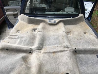

Pics may not be needed, but why not:

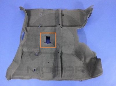

Best I can tell, the difference in the 2006-2008 carpet would be this cutout:
I'm fairly confident it's not the M/T provision but is for some other black module that mounts in that area.
On my 2005, the center folding seat/lid console should cover that hole.

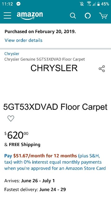

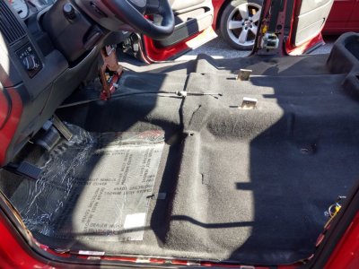

So turns out I had actually bought 5GT53XDVAD, not F (same thing, just earlier part number version) on Amazon (they had the best price): https://www.amazon.com/gp/product/B00XPZK868/ref=ppx_yo_dt_b_asin_title_o00_s00?ie=UTF8&psc=1
Unfortunately they don't have any version of the one you're looking for, but I hope it works out. Lay out flat in the sun for as long as you can to let it unroll and settle out. After I put mine in the truck and let the sun cook it inside the truck a little more. Laid right into place except for where I put the console bracket (had to cut slits for that).
